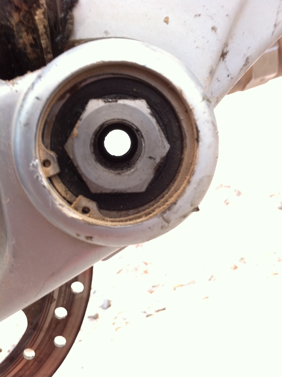

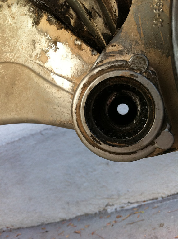

OK, long story short, I loaned my bike to a good friend who took it down to La Paz.
100km out of lapaz he noticed that the rear wheel was rubbing on the pannier, thought he broke a pannier, only to find a bunch of lateral slop in the rear wheel.
He thought the final drive failed, and worked out to get get the bike in a ranchers truck to get to La Paz.
I had my spare FD shipped from chicago to me in LA in preparation of riding it down to him asap, but since there's no fluid I don't believe the FD has failed.
Now that I have some photos, and have talked with him it looks like the main bolt that hold the FD on came out, and he lost the insert thingy that goes in left side in the bearing to hold it on.
Does anyone have a photo of the FD that clearly shows this assembly?
here's what I have from him
Thanks!

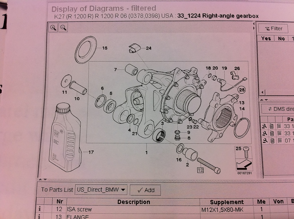

New parts ordered, now just looking for photos to send my buddy... I looked through all of mine and can't find one with the wheel off for the left side.
It's very strange that this bolt would come loose since it's micro-incapsulated with red thread lock.
Last time this bolt was replaced was when I replaced the FD, 40,000 miles ago.
Checking the torque on this bolt might something to add to service for higher milage 1200R's....

Looks like the screw is part 16. I'm at work, so this is the best I can do. Hope your buddy gets it worked out.
Bill
Re: Roadster broken down in Mexico, HELP PLEASE!
Thanks Bill, yeah I ordered part # 2, 3, 10, 12, 16 (on my parts drawing).
Luckily the parts are all in country and will be here tomorrow.... now I just need to get them to La Paz.

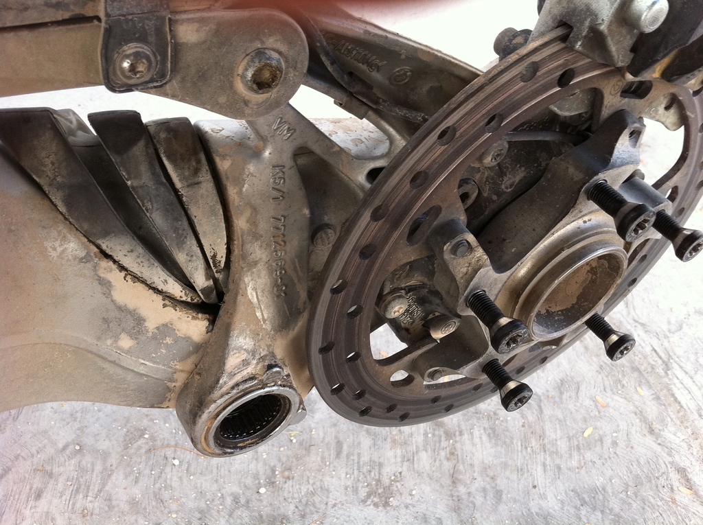

I know this is after the fact but here is my best pic of that.
