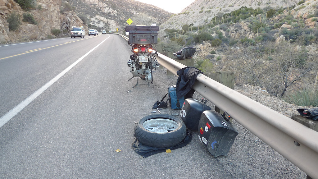

Changing tires is pretty easy, here's a link to a much better write up than mine and even though it's a dirt bike, most of the procedure still applies.
I use a Marc Parnes balancer, sometimes, other times I just ride and have never felt anything.
Cheers
http://www.advrider.com/forums/showthre ... ight=butyl
You never know when you'll need that tire changing skill when a plug just won't work....
