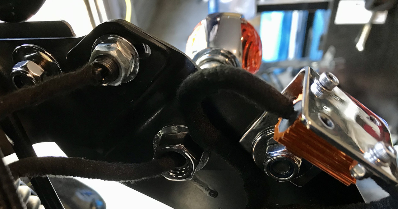

The Hella bar end indicators from the likes of the R69s have always caught my eye. I wanted to have something that had the looks but still met the Australian design rules (and wouldn’t cause problems at rego time). The brief was to look right , look factory, use the standard mounting points and look factory and for bonus points use LEDs.
Making up the stainless mountings and fabricating the replacements for the incandescent globes turned out to the the easy bit. Getting the LEDs to work was not going to be a problem, I already had a Kisan flasher….how very naive.
Bar end mirrors are earthed to the frame. Out of curiosity I wondered if that would work. Zappppppp! My Kisan flasher was now a fused piece of slag and the indicators would light once and stop. The issue was obviously ballast to I bought ballast resistors but they can run very hot so I made customs stainless mounts (as an aside I got too clever by half and thought I would also install small side firing indicators for safety.
Everything re-wired and mounted and they work…sort of. The flash was too fast and wouldn’t pass registration.
The temptation to set the whole thing on fire and dance around the burning remnants cackling like an escapee for an asylum for the criminally insane called to me but I resisted. It may be obvious but I dislike auto electrical work
I saw your your posting about LED indicators and read it more closely. 15 mins modifying the BMW relay and it all works correctly. If I added up the time to find the ballast, make the mounts and fiddle around with the wiring changes I might get annoyed, so I have chosen not to.
