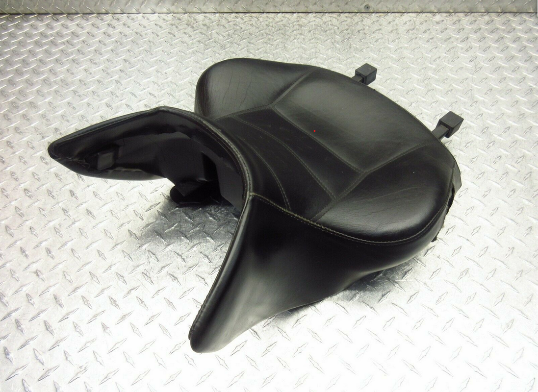

(Sorry if this is repeated information for anyone)
There are 3 heights: LOW, HIGH, and TALL.
HIGH was the OE/standard seat on the R1150R.
TALL was the OE/standard seat on the Rockster.
LOW was the optional seat for either bike offered to owners of shorter stature when buying (or as an after-market option).
At least - that's as far as I'm aware the situation was in the UK. Other countries may have had it differently.

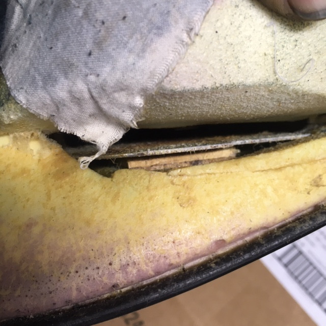

Re part numbers: the Part number on the seat BASE [2 328 718] is (I believe) the part number for the BASE(or PAN) ONLY.
IE - each seat is an ASSEMBLY of: base, foam, cover, rubber bungs. So - the part number is the BASE manufacturer's (SHAD) part number, NOT THE BMW SEAT PART NUMBER.
Obviously, for each of the 3 seats to fit the same bike, they would have the same BASE.

So - 5 different official BMW part numbers, 3 heights, 3 colours. (both the non-black colours are on the 'HIGH' seat).
CAVEAT: this is my understanding of the situation.
Photos below are from the original FaceBook Group post, so may disappear if FB changes their links.#
