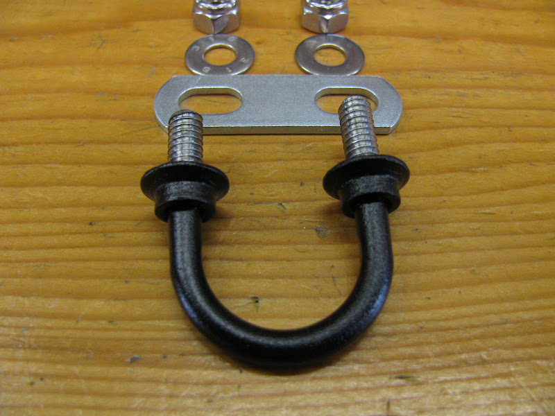

Well, sometimes we have to be creative. I checked several vendors and could not find anything that had an opening large enough to take the 0.5" end of my cable lock. Aerostitch had two items but not with an opening large enough for the cable lock. So I fabricated my own.
Started with a u-bolt and flanged hex nuts. I machined down the flats of the nuts so it would not look quite so home-made. After professional powdercoating textured black the result is below.

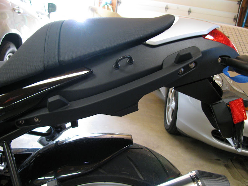

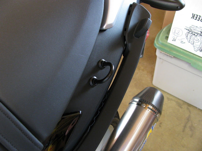

Installed on the bike

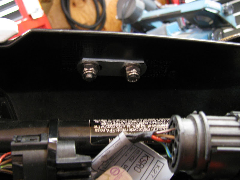

The result turned out fine. Fine for locking a helmet to the bike or bungeeing a light load. Useable with or without the side cases on. With the lock nuts and backing plate on the inside it is suprisingly sturdy and apperance is understated and not objectionable.

Widetrack: very nice!
