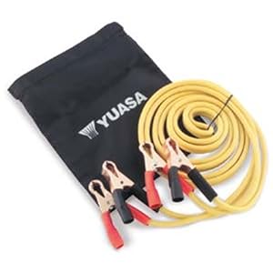

I carry a set of Yuasa Motorcycle Battery Jumper Cables they're a little more expensive than some others but this is a case of you get what you pay for. The cheap sets have a few strands of heavy wire in them but the better sets have a large amount of fine wire. That makes them more flexible and also more efficient at transferring voltage (amps) from one vehicle to another.
When you Need jumper cables you don't want to be screwing around touching valve covers together or using a set that was designed for automobiles when for the price of a tank of gas you can have a premium set that was designed for a motorcycle,
http://www.amazon.com/Yuasa-Motorcycle- ... B003TI2DD2
