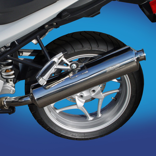

I have a Ztechnik Slip on. I run with the baffle out and it sounds like a motorcycle without being obnoxious IMHO
I doubt if it does anything for performance or gas mileage, but I couldn't stand the sewing machine sound.

Got my Ztechnik exhaust today. Fitting was a little tricky since the OD of the exhaust connector is the same as the OD of the header. The little slots are too short to expand the exhaust connector enough. I had to saw longer slots and pry the thing open. Some slippery anti-seize helped wrestle it on. Clamped up everything and started the bike. Leakage was still too much for my taste at the junction. I took it apart, added one layer of header wrap and re-tightened. It's snug and sealed, but I don't like having that fiberglass wrap on there. Will fix that up later...
Sound is rather near to stock, so I pulled the dB killer. Very nice! A rumble without that harsh and nasty straight-pipe sound. Smooths out at driving speeds.
Off for a longer trip tomorrow.
