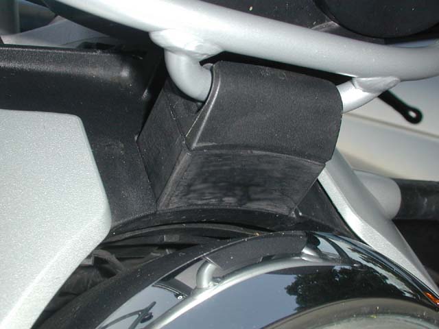

Mollygrubber wrote:Well, I stole your idea and fabbed up some similar mounts, stuck my 18" Cee Bailey back on, and wow what a difference!
It seems smoother the faster I go! Not perfect, but way more perfecter than it was...
I'll attach some pics of my (bad) fabrication job when I get a chance.
Thanks for the inspiration xprof!
Peter
Here they are, in all their mal-focused, poorly exposed glory... I tell myself I'll go back and make them beautiful, but that probably won't happen. I guess I should have sanded them or something - pretty nasty close up. They are, however, mechanically strong. I used aluminum and not steel as I don't like rust.
I used zip-ties for insurance as I sometimes get a little enthusiastic with the right handgrip, and didn't want a mouthful of Cee Bailey 18" screen at high speed.
Not using torx heads may seem sacrilegious, but you can actually tighten these with a wrench from the side, rather than trying to get at them from above (the bend is right in the way...)
Hmmm - I think I should have de-burred the holes for the zip ties - may cut through pretty fast with all the vibration... well, that'll be when I pretty them up (and maybe make the tops even for pulchritude's sake)
Here you can see the slight bend I put on the mounting tabs, a couple of degrees only.
Angle of attack is now slightly greater than that of the fork(?) tubes... works pretty well - for now - muah ha haaaa...
Thanks again for all the helpful chatter and inspiration guys, this makes for a really nice ride. :biggrin:
