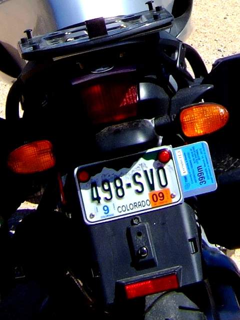

I'm considering several options to add some additional lighting to the rear of my R1150R. Currently I only have the stock tail/brake light, and that hides under a top box. Below is a picture of what I'm starting with (without the top box).
  • P3 Lights Bright modulated tail light LEDs, with flashing brake lights, about $150 including mounts.
  • Hyper-lites Tail light LEDs, with flashing brake lights, about $115 with mount.
  • Kisan signal minder Converts turn signals to running lights and flashing brake lights. About $145 including clear lenses from Clear Alternatives and red 1156 bulbs for the rear tail/turn/brake lights.
  • Top Box solution, replacing the 2.25" reflector on the top box with a 2.25" LED circle. This costs about $70.
  • Ghetto solution, an LED truck stop/tail/turn light mounted below the license plate. This could be as cheap as $15.
I know the first three options will work correctly with the R1150R and won't cause the brake warning light to come on, but I'm not sure about the last two solutions. Can I splice an LED light into the tail and brake light? Will the extra small amp pull of the LEDs cause a problem?
I'm currently leaning towards the Kisan based solution, as it gives me running lights at the front as well as the rear, and also seems like the simplest setup to install.
Due to the location of my parking pass bracket, it will be difficult installing the P3 Lights or Hyper-lites next to the license plate, as most people seem to do. I could go without the parking pass bracket, and attach the pass directly to the fender, below the license plate. It also might be possible to modify or use a different mounting bracket to put the LEDs below the license plate.
I like the top box light because it will give me a high center brake light, but I don't always have the top box on, though I usually do for commuting. Mostly, in order to even consider the truck light or top box solution I need to know if there is any problem splicing into the tail light and brake light wiring.
Thanks in advance for any advice, and I'm also interested in pictures of what other people have done.
